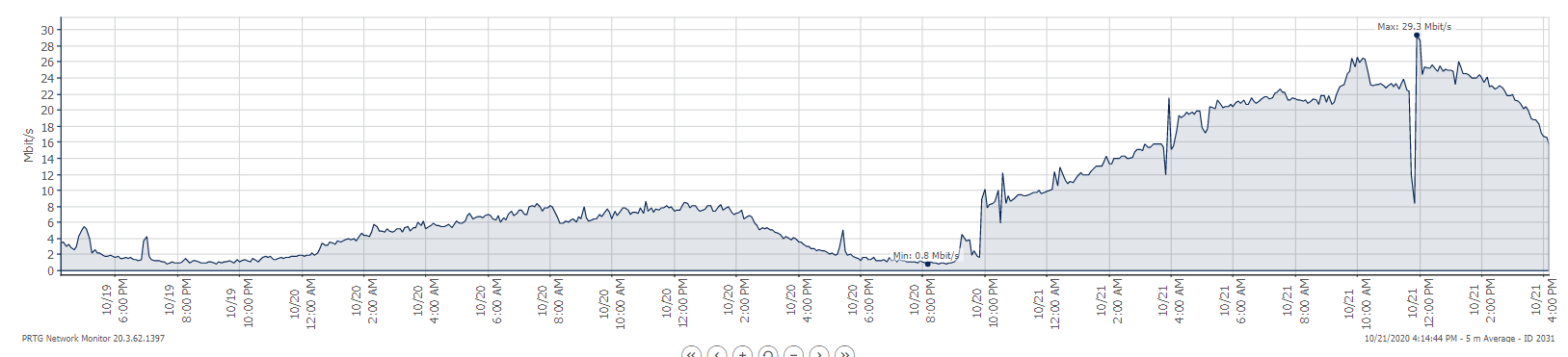

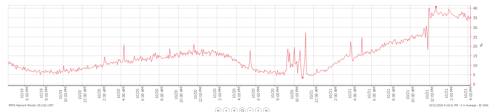

by Derek » Wed Oct 21, 2020 7:20 pm
Test was on 800 - 1800 users. Same host, same machine.
Adch++ is a win win - bloom to reduce traffic.
Lower overall CPU usage.
I did end this test slightly earlier that planned thus graph for the LUADCH (right side) is a bit shorter, but you get the point.
Although ADCH++ outperforms LUADCH when it comes to CPU/Bandwith important for large hubs, LUADCH is still a nice soft with settable TLS version, blocking 0 share users and many other options that ADCH++ just doesn't have.
Also i need to mention i tested x64bit ADCH++ vs 32bit win LUADCH.
Short test on LUADCH x64 linux build - showed even more cpu usage vs 32bit somehow thus i'm calling is irrelevant atm.
CPU usage - on the left is adchpp - right side luadch:
Bandwith usage - left - ADCHPP right LUADCH:

For testing purposes both adc and tls connections were allowed on both hub softs. This would allow for more users. On TLS strict we will lose all old clients. I was hoping we gonna get 3500+ users with fl add- but looks we gonna be topping on 2000 on weekends and 1800 during weekdays.So not too much to stress stest with. I was able to build x64 bit LUADCH on linux. I had a crash within 10 minutes of startup. No error message - just shutdown. Also had adchpp crash once. After running 30 days. Gona stick to adchpp for now.
